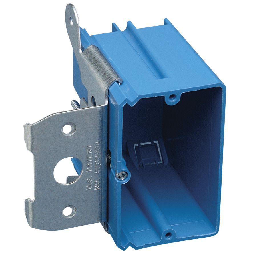

Hey Guys,
Great Site!!
The question is coming from a computer geek with a pocket protector - I am bidding on a wiring job in New Jersey - moreover Mt. Laurel. I have been told code inspections are rough. The electrical contractor has used braided steel covered cable and metal electrical wall boxes. I know our data/telcom cabling falls under the low voltage section of the new jersey code. I have talked to several people who do electric all with mixed opinions on the situation, some say yeh some say no. We normally use a non metalic plastic gang box which is screwed to the metal studs prior to the drywall being hung. Is this acceptable according to the code in New Jersey??
Will this pass the wall inspection even though its not metal?? Anyone have any experience with the township of Mount Laurel, NJ. and this specific code. Any pointers from the Pro's would be great.
Thanx for your help in advance.. Geek

I don't know where you are but around here it's not uncommon to put in boxes for datacomm connections.
celtic
NJ
Re: NJ Electrical Code for Data/Telcom Gang Boxes??
...or NOT even use a box:
(MPLS ~ CADDY? Mounting Plate Brackets (Metallic) Screw-On Support....this is for old work)
or...
(MP ~ CADDY? Low Voltage Mounting Bracket - New Construction)
Both Caddy products are available in single or two gang configurations.
Some "contractors" will use a mud ring screwed right to a stud.

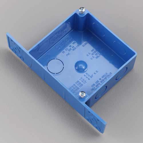

EC
Well, I'm not going to get into whether it is right or wrong to use boxes you should be able to decide that on your own. The worst prewiring jobs I have seen always seemed to have Carlon single gang bang- on plastic boxes and about 6" or less of slack to work with. :(
The compelling reason not to use boxes is because it is much easier (even possible) to maintain the correct minimum bend radius on cables such as cat5 and coax if you have the open bay to contain your slack rather than stuffing it into a box. Bend radius is a major issue when installing communications cables.
The length of your slack should be enough to allow you to comfortably install the jack or connector and leave some length to cut it back for servicing if necessary in the future. I like to see at least 12" or more.
In instances where a box must be used such as with pipe or in a fire rated partition, always use the deepest largest volume box keeping in mind the number and type of cables. You don't want them to be pushed into the box and bent at an angle behind the connectors when you install the plate. Deep 1900's with raised plaster rings work well unless there are a lot of cables. Then you should consider splitting things up with multiple boxes and plates.
-Hal
