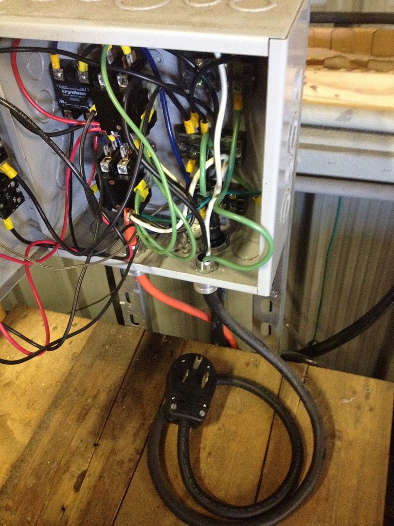

What is that mess running (or not)?
SceneryDriver
Crafty use of an extension cord too, it looks like.
Are they taking the EGC and using it to get 120V for control power?
You get sunshine, bikinis, and all the sweet jobs. Not fair.Keg washer at a micro brewery.
Minor compared to turning the ground into a neutral
