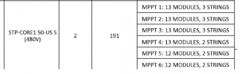

Can you help with this sizing calculation?
There are 191 SunPower Modules(SPR-E20-330-com), and each has 330W, So the total power DC KW = 63.03. The module has an open-circuit voltage=64.9V, a short circuit current = 6.52A, and a rated current=6.04A.
Open-circuit power generation with rated current = 64.9 X 6.04 = 74.87123 KW
After the low temperature at rated voltage calculation, the voltage at each module is 62.46V and rated current = 6.04, So the generated power = 72.05635 KW.
The preliminary design has an SMA inverter (STP-Core1 50-US S, 480V) with a maximum capacity of 75KW and efficiency = 97.5%.
As per the above calculation, I'm assuming this inverter (STP-Core1 50-US S, 480V) is undersized. I guess we will go for a larger size of the inverter.
I really appreciate any help you can provide.

1) voltage under load is lower than open circuit voltage, so your power calculation is too high.
2) peak power generation only occurs infrequently. It often makes sense to intentionally undersize the inverter relative to the DC array power.

A challenge in pairing that module with an SMA Core 1 inverter is that the E20-330 is a high voltage, low current module; even in areas that don't get very cold the maximum 1000V string length is only 14 modules. The Core 1 inverters have 6 MPPT channels and each has two unfused inputs, so the maximum number of E20-330 modules you can connect to any Core 1 inverter without resorting to triple stringing and string fusing is (12)(14) = 168 modules, or 55440W DC. That's only a 1.11:1 DC:AC ratio for an STP50 and 0.887:1 for an STP62.

That's right, thank you. Here is the Inverter and string summary. Each inverter has 191 modules.

You definitely don't need a 75kW inverter for 63kW nameplate of modules, as a matter of general principle. Unless the inverter is already purchased or there is some other devil in the details, my guess is that it would be more cost effective to provide a few small fused combiners on a smaller inverter.

He could use a 50kW inverter if loading 126% is OK for him. The SMA Core 1 is only available in 33.3kW, 50.0kW, and 62.5kW versions. They all have the same DC section, though, so he will be triple stringing in any case.
Sunpower modules and SMA Core 1 inverters have a special relationship with respect to rapid shutdown; maybe that's what he is dealing with. SPR MLSD (SunSpec compliant) modules use the Tigo TS4-R-F device and I haven't been able to find an inverter company other than SMA that will certify communication with the TS4-R-F.
