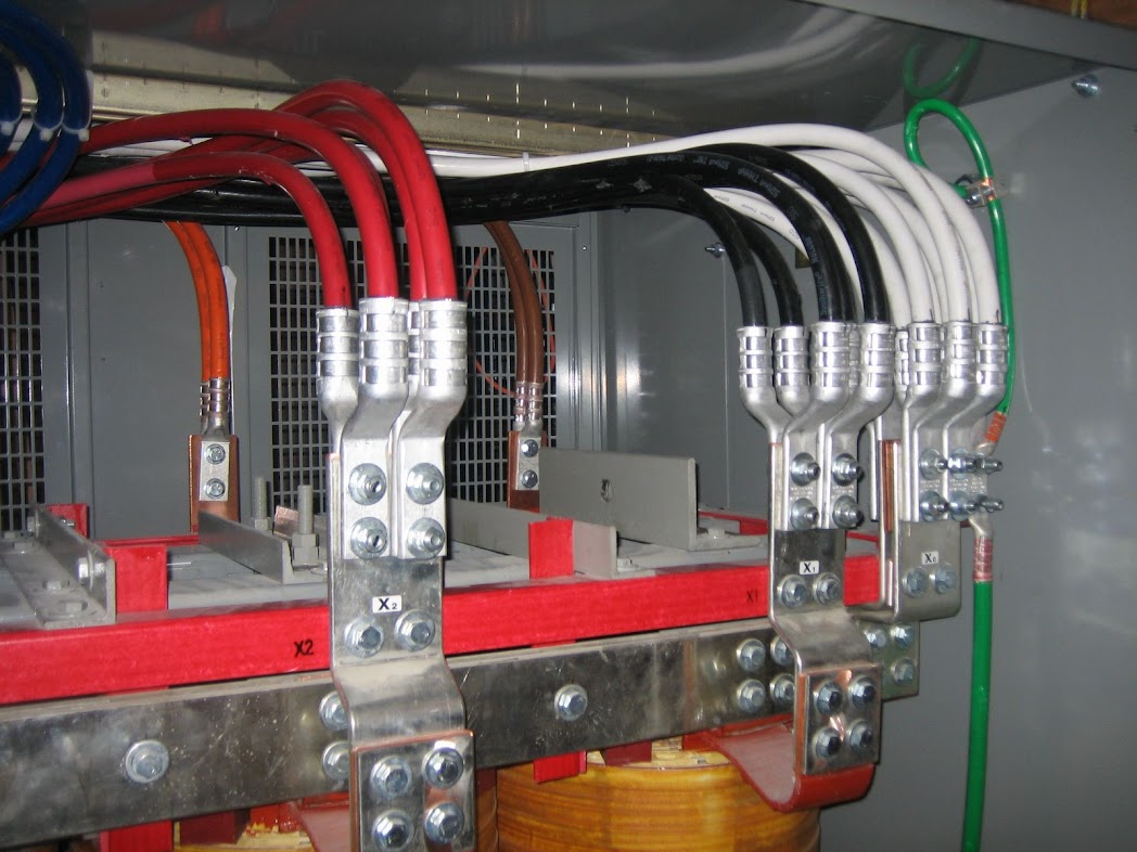

How many crimped on lugs can be stacked on a single stud? If I have a stud that is 2 inches high and I use stacking lugs, with jam nuts I could get more than 2. I have only ever seen 2 lugs on a stud and was wondering if there is a rule about it. See the picture below.

Provided there is enough clearance, you can get 4 lugs on a stud without bending or otherwise modifying them to fit. Two standard, two offset, one matched set inverted.
AFAIK, there is no restriction on doing this as long each conductor is a member of the same circuit.

As Smart stated if you get the right combination of lugs you can stack many on the same stud. Here's 10-500's on the neutral, if you look closely 4 of those might fit on one side if the studs are long enough.
