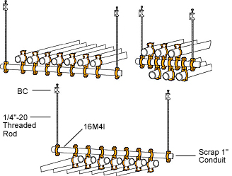

We use scrap empty EMT to support commercial high hats, the 1/2" EMT fits perfectly in the brackets on the sides of the fixtures.
We also on occasion have used EMT like this.
Lightweight Trapeze
