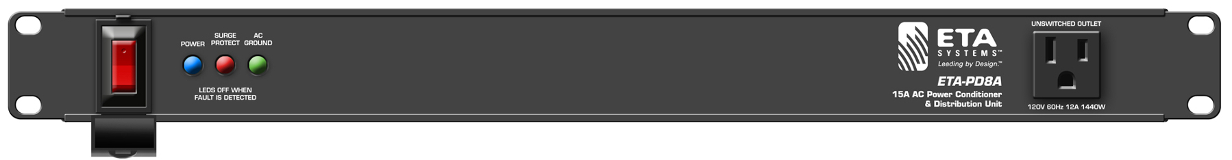

We have a cord connected 800VA UPS. It does not have sufficient outlets. Can a relocatable power tap (non-surge type) be plugged into this UPS? I know relocatable power taps can not be plugged into other power taps; however, the UPS is not UL listed as a power tap. Could a UL listed as a PDU outlet strip be used? Somewhat the same thing, but a different UL listing.

Not sure I've seen a "UL listed as a PDU outlet strip" in the flesh but I believe those are the ones that mount in a rack space. Also what I've used are Wiremold Plugmold strips up the inside of a rack, supplied with SO cord and a plug, plugged into the PDU in the front. No reason you couldn't do the same thing with a UPS in there someplace.
Check out these that I've used-
It's usually cheaper to to make your own Wiremold Plugmold strips with a line cord then to buy them from Tripp Lite or others.
-Hal

Just a thought here... How about a piece of "PLUGMOLD" with a piece of SO or SJO cord and a male plug to the UPS mounted in the rack (I am presuming this is a server rack). This could give you more receptacles, and eliminate the MOV issues, and hopefully keep the inspector happy.

Yep. Unfotunately, one then runs the risk of some bright-eyes saying that it's not a listed device and can't be used at all. (And add the assembly time to the cost.)
Well then, get one from TrippLite that already has the line cord and plug.
Actually, power distribution in a rack that is plug and cord connected to a receptacle isn't even covered by the NEC. But that's no excuse to cobble something together. There is plenty of equipment with which you can do the job properly.
