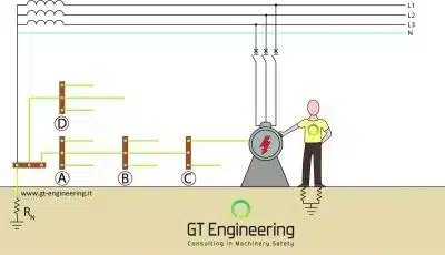

I'm really confused by this engineering article. How can the maximum touch voltage be 92 volts on a 230 volt system when in theory it ought to be 115 volts or higher?
In case of a system voltage of 230 Vac phase to neutral, the reason why a time of 0,4 seconds is specified is because 0,4 seconds is the maximum time a person can be subject to 92 Vac. That is the normative touching voltage in a TN system operating at 230 / 400 Vac.

Looking at the diagram, they appear to be calculating the voltage divider effect using the resistance of a combination EGC and other parallel ground paths that has a lower resistance than the path of the ungrounded wire. If the two resistances were equal, the the voltage would be 115 or so. Basicallly 1/2 of the line to neutral voltage.

It is just a standards calculation generic assumption that the source will maintain at least 80% nominal voltage. Thus 115 becomes 92. The 0.4 sec clear is based on certain generic assumptions which may not hold true for a specific install.
The actual touch voltage can be higher of course depending on source stiffness and relative size of phase conductor to neutral conductor, etc.

Alright, dumb this down for me... a short circuit will pull the voltage down at the spades of a transformer due to its internal impedance (R+jX) of said transformer, thus the source (X0,X1) is not actually 230 volts but rather 184 volts and as such the restive divider will give 92 volts relative to remote earth assuming phase and EGC are the same size?
Ah, good point. They might be taking other paths into account. Perhaps even local or building elevations in voltage?

The touch voltage is equal to the voltage drop on the EGC. The amount of fault current flow combined with the impedance of the fault return path results in the touch voltage.
exactly.
